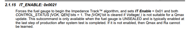

Hello there,
according to the SLUUA35 Technical Reference Manual (pg. 23) IT Enable can have values between 0x0 and 0x3. Unfortunately I can not find any explanation what the meaning of the different states is.
I would assume that there are only two states (enabled/disabled), so can anybody explain what the remaining two states indicate and which state is indicated by which value?
Thank you very much!
