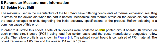

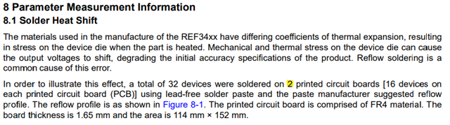

Please see below:
Version C:
Version D:
Please keep in mind that the most up to date datasheet revision is version F:
