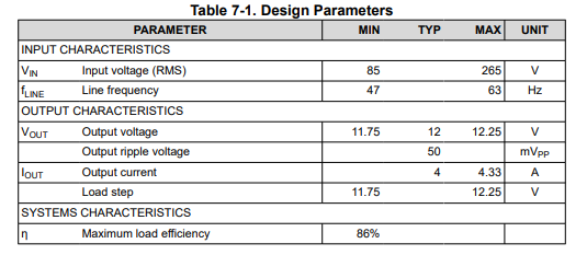

    3) I have updated the operating conditions based on the design parameters table given in UC1842A datasheet (Page 15, Table 7.1). Now it matches the Nps value given on the datasheet. Please refer to the updated Webench link: https://webench.ti.com/appinfo/webench/scripts/SDP.cgi?ID=90E155D6B74DC2CD

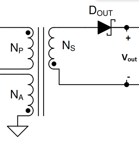

    The document about the transformer only shows primary and secondary winding calculations, My design has got Auxiliary windings as well. How do I do calculations for that.

    2) You can use this equation to design your Aux winding:
