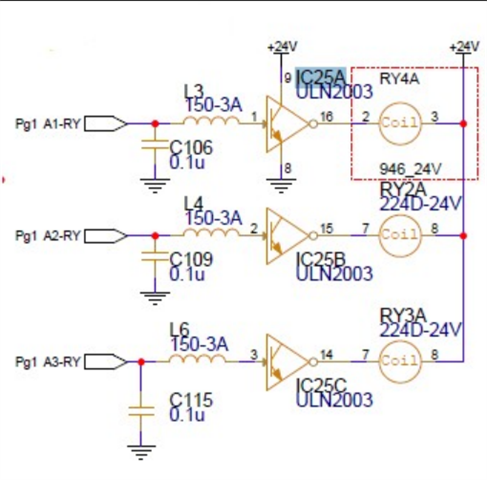

hi TIM
Die size change?
we use the ULN2003 in high voltage output machine,
old date code is fine, but new date code fail rate is high

Can you comment on what the loading conditions are for each channel running at the same time? As long as none of the abs max parameters are being in the datasheet, we would not expect any significant increases in failures.

HI SIR
We change to UTC 2003, all pass, no fail , did you have any suggestion?
we use the ULN2003 To driver the Relay (5000v), the end application is the Hypot tester ,TI also use the machine for isolator test
thanks
Hi Alex,
I'd like to draw attention to Tim's comment above:
"Can you comment on what the loading conditions are for each channel running at the same time? As long as none of the abs max parameters are being in the datasheet, we would not expect any significant increases in failures."
This will help us determine under what conditions the device is running to see if there are any concerns.
