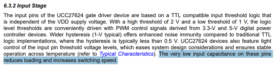

Hi TI,
Can you please let me know what the input capacitance is for the In+ logic input for the UCC27624?
Hi TI,
Hello Alex,
The input capacitance is not specified, but it is a very small value.
Annabelle
I don’t need to know the exact amount, but it would be very nice to know if it’s <= 1pF, or <=3pF, etc. Please advise
Hello Alex,
I am working on obtaining this value for you. Thank you for your patience.
Annabelle
Hello Alex,
About 1pF comes from the the die. The package adds about 0.3pF, totaling 1.3pF.
Annabelle
