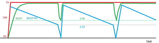

I have designed output voltage for 5V with feedback resistor and output current is 150mA to 400mA.
I have kept the EN pin floating to turn on the device even with lower voltage.
Let's say I apply 5V input for long period, the output voltage will also be nearly 5V as the device operate in 100% duty until BOOT - PH drops below 2.1 V.
1. Can we determine the rate of discharge of the BOOT capacitor to determine how long the 5V remains constant until the BOOT - PH drops below 2.1 V?
2. When BOOT - PH falls to 2.1V, the MOSFET will turn off and output capacitor starts discharging and when it is 5V-2.1V=2.9V the BOOT -PH rises and output rises 5V so BOOT - PH also rises nearly to 5V. This keeps repeating right if input voltage is constant at 5V. Is my understanding correct? (see graph below and correct if I am wrong)
Thank you,

  • Hello Onkar,
    For the second point, I understand Vout should fall below such that BST cap charges above the BST UVLO rising voltage.
    Let's say output current is 150mA to 400mA. Then does the output voltage fall to 2.9V (5V-2.1V) like the graph below?
    Could you please share the data how the output voltage behaves when output is set to 5V and input of 5V is applied?
    Also, can i know light load means how much current?
    Thank you,

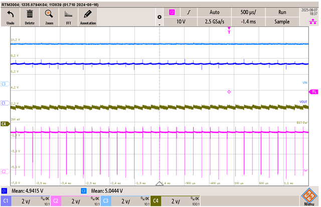

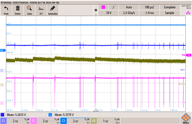

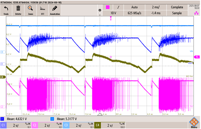

  • Hello Vishwas
    I tested this behavior on EVM,
    Check the following waveforms.
    Vin = 5.28V, Vo = 5.20V, Io = 140mA
    Vin = 5.27V, Vo = 4.6V, Io = 140mA
    Vin = 5V, Vo = 4.26V, Io = 140mA
    On EVM, it needs at least 170mA current to come out of this behavior
    VIN = 5V, Vout = 5V
    The simple solution would be to have dummy load of 50-100mA, assuming your application allows it. Or you can tie a diode from Vout to BST pin as mentioned in Methods to Improve Low Dropout Operation with the TPS54240 and TPS54260 (Rev. A).
