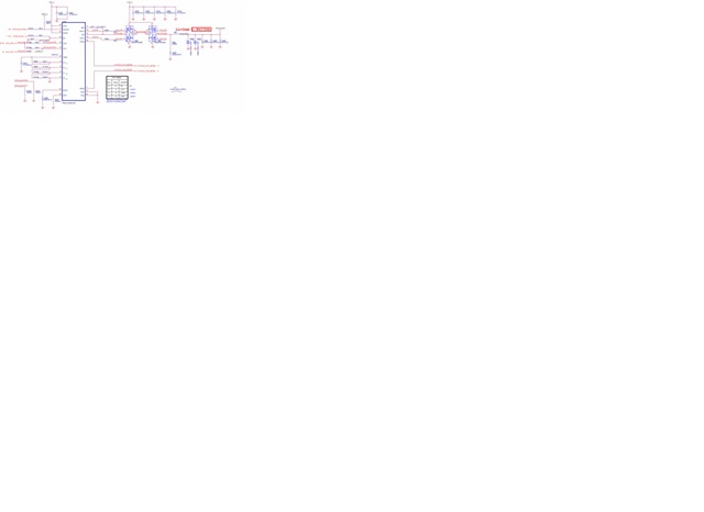

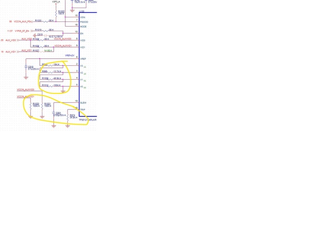

Hi
Could you help check the below TPS51215A schematic and any need to adjust
The inductor was 0.22uH with a DCR of 0.63mohm and was replaced with a 0.22uH with a DCR of 0.29mohm.
The inductor DRC is different. Does the resistance in the yellow circle on the circuit need to be fine-tuned?
    The graphics you inserted into the post do not have high enough resolution to be readable for a schematic review.
    If they had a working design using a 220nH, 0.62mΩ Inductor, and it was replaced with a 220nH 0.29mΩ inductor, the change in the inductor's DCR would not require a change to the design.
    If you need more review than that, we'll need higher resolution schematic images to review.
