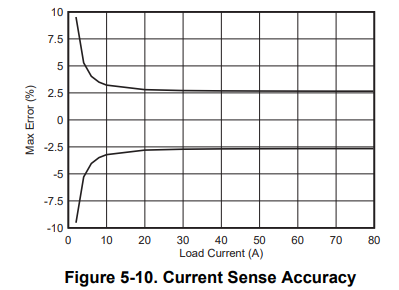

Please help to calculate the current accuracy when the current is 10A for the channel A of TPSM831D31 ?

I will check for this data and get back to you tomorrow.
Troy
Current accuracy for TPSM831D31 will be similar to the accuracy of the power stage used internally. You can refer to below graph, which shows power stage current reporting accuracy:
