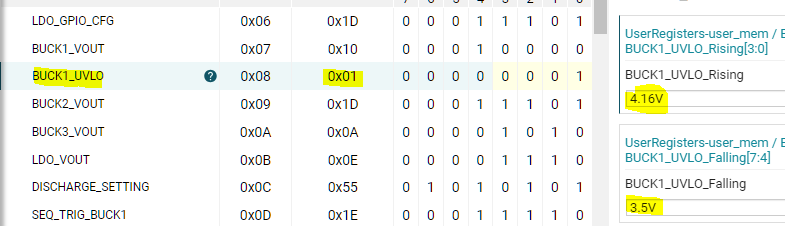

      A2: What do you mean "PVIN_B1 UVLO=01"? I guess you mean BUCK1_UVLO=0x01 as following. If so, same answer as A1.

    Thanks for your explanation, For Q1, When the input voltage is 4V, we should set the PVIN_B1 UVLO=0x00, which means the rising voltage is 3.64V and falling voltage is 3.5V, but its difference is within 0.5V, so is it possible for TPS65035x works in VIN=4V?

  • Hi Florens,
     As I've answered; it depends on the VBUCK1 level and the load on the Buck1. For example; TPS65035x works well when PVIN_B1=4V if VBUCK1=3.3V with 0.5A load; it doesn't work for VBUCK1>3.3V with >0.5A load.
