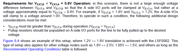

Could you please advise if LSF0002 could be used for VrefA=VrefB?
My customer VrefA=VrefB=1.8V. But the power rails are different. So, they want to separate by a level shifter.
In datasheet, we recommend VrefB>VrefA+0.8V. Also, there's a description for VrefB<VrefA+0.8V scenario. So please help to advise if it works for VrefA=VrefB=1.8V. Thanks.

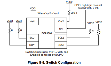

  • Hi Terry,
    Switch configuration of VREFA= VREFB is supported by the LSF0002. This is to be added to the datasheet in the next revision update, and the PCA9306 datasheet can be referenced in the meanwhile:
