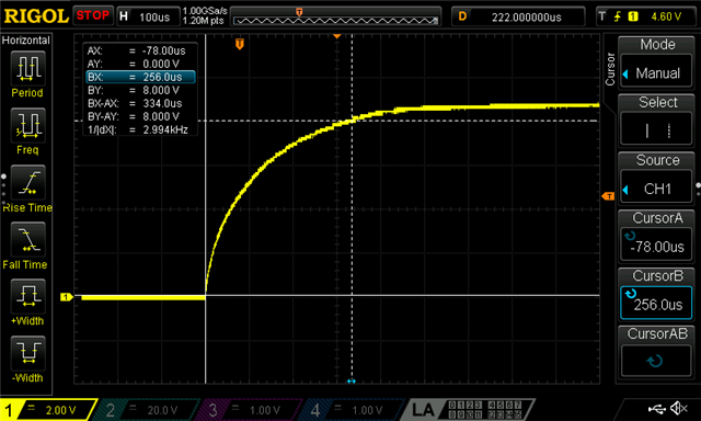

In reference to TIDA- 010247 we are implementing a design with 6 Charge and 6 Discharge FETs of total gate capacitance 51.6nF  but after implementing the reference Multiple FETs with the BQ76952, BQ76942 Battery Monitors (Rev. A) (sluaa09a), the turn-on time of the DSG gate w.r.t PACK+, was not fast enough for our application (~250us).

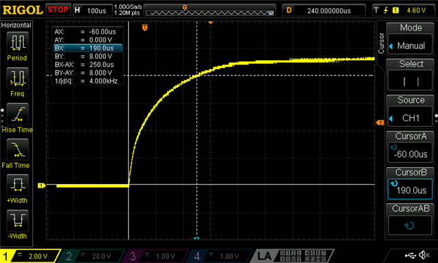

On increasing CP1 capacitance to  4.4uF, which is double the maximum recommended value, we observed 25% improvement in the turn on time (~220us).

    After speaking with my team, this is what I have gathered:
    Using this large cap is not an issue as long as you have tested it well. The main issue of having a large CP1 cap is that it takes longer for the charge pump voltage to rise to full value when it is first turned on (typically when you first power the device).
    You might look on a oscilloscope at the time it takes CP1 to rise to full voltage, and the time when you will turn on your FETs, and make sure it is up enough before the FETs turn on. If the voltage is still rising and you have turned on your FETs into a large dsg load, the FETs would have a strong Vgs, so it may overheat. Check this, and as long as this voltage is not rising then it may be safe to use.
