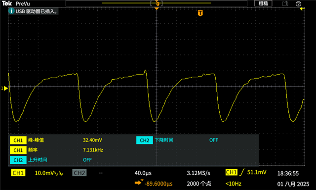

When loaded, there is a buzzing sound, but there is no such phenomenon when unloaded. After power-off, the noise lasts for 3-4 seconds (it disappears immediately after removing the load, and the measured output ripple is 230mVpp).
After adding LC filtering, the measured output ripple is around 30mVpp, but there is still a buzzing sound.

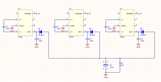

[Attachment 1]: Schematic screenshot

As shown in [Attachment 2], if capacitors C4, C5, C6 are not installed, the overall output is -8V, but the diode voltage difference is as high as 2V, which means the voltage of TL7660 PIN5 is -6V.

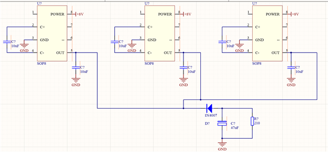

3. As shown in [Attachment 1] and [Attachment 3], since three TL7660 chips need to be connected in parallel, may I ask how to place the diodes more appropriately?
  • Hi Anson,
    I don't think there is the must to add the diode. The ultimate purpose to parallel is to lower the output resistance and strengthen the load capacity. Do you have any other consideration to utilize the diodes?
    Could you first try enable one inverter to see if the buzz is still on?
