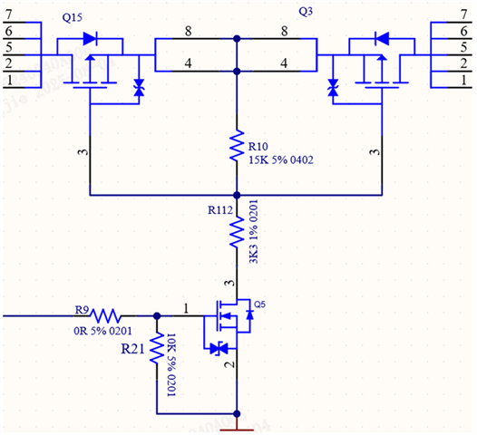

Does TI has solution to prevent current flowback? Currently customer adopt below circuit to achieve it.
  • Hi Kailun,
    What is the application condition? Usually we also use the similar solution to prevent flowback current, you can take a look on TPS61178 or TPS61372, depends on the voltage/current required.
