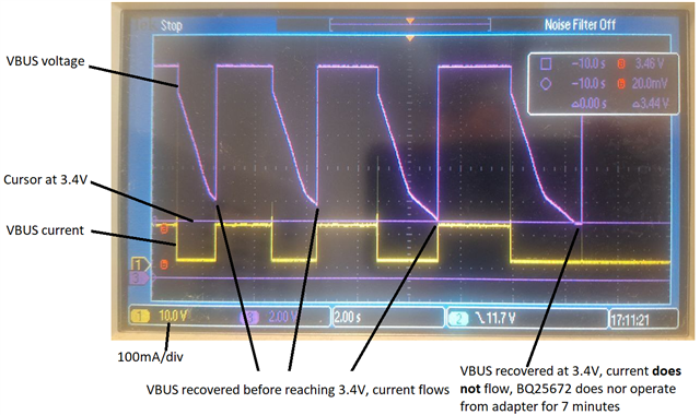

In our design we use BQ25672 for 2S Li battery charging and power management.
Issue descruption: after input voltage interruption for several seconds interval, BQ25672RQMR does not operate from adapter.
As AC adapter has a bulk output capacitor, if AC voltage is interrupted, VBUS voltage decreases gradually. If AC recovers when VBUS is ~3.4V, BQ25672RQMR will not operate from adapter.
PG Status: NOT power good, VACstatus: present, Poor Source status: normal.
In case of operating without battery, trere is no SYS voltage for 7 minutes.
Or it needs to wait for ~1 min without AC (to discharge capacitors so that VBUS is below 3.4V) to recover VSYS.

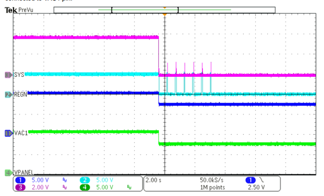

  • Hi Vasyl,
     Does the fault flag in REG0x22[4] report a previous Poor SRC, resulting in converter shutdown for 7-11 min?  Does EN_HIZ bit =1 in REG0x0F[2]?  Since VBUS has to fall below 3.4V to fix, it could be either.  The SYS short timing is shown below:
    Jeff

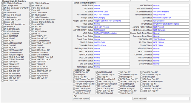

  • Hello Jeff,
    Yes, EN HiZ bit is set.
    See also other settings:
    Clearing EN HiZ solves the issue, but in case of no battery operation host controller will not be able to clear it, as it has no power.

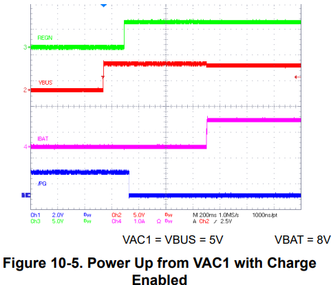

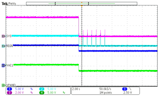

  • Hi Vasyl,
    Normal startup timing is below:
    Poor source detect occurs immediately after REGN comes up.  If poor source fails, the charger goes HiZ for ~10min and tries again.  If not poor source but SYS falls < 2V, the charger retires to get SYS voltage up 7 times with the timing below.
    If SYS does not come up, the charger sets EN_HIZ bit =1.  Either a full power cycle or I2C write or VACx pin toggle with VAC>UVLO per app note above is required to reset EN_HIZ bit to 0.
    Jeff
