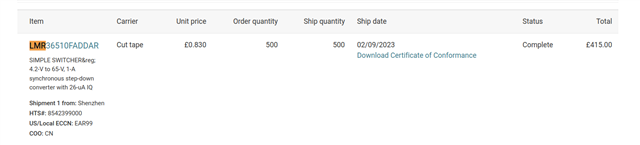

I have a circuit that uses the LMR36510 to generate +5V from a power input that can be anywhere from +12V to +48V. It appears that even when there is no load, the circuit draws 7mA when supplied with +12V, which is much more than I was expecting. Circuit is shown below:
The inductor is a Bourns SRP7028C-220M.
The input and output capacitors are all MLCCs, output is X6S, input is X7R.

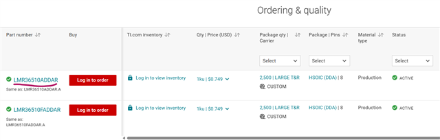

I have to say that the circuit seems to work fine, but it seems to enter PWM straight away, and not PFM mode which I was expecting when not loaded. In this product, the quiescent current is very important.
Any thoughts/comments much appreciated.
