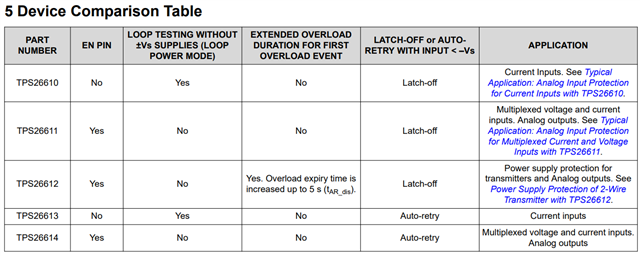

How does the TPS26610 reset after a latch-off when input < -Vs? If the input rises above Vs does it automatically recover? Or does it need to be power cycled?
