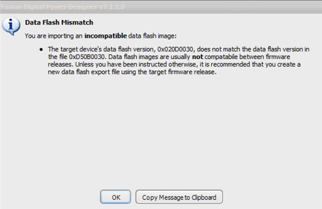

We've encountered inconsistencies while programming the UCD90320 (PMON) using the PMON dongle at our debug bench. We tested multiple file formats with the following results:
  • .tifsp file – Programming successful; board powers up.
  • .xml file – Programming successful; board powers up.
  • .hex file – Programming fails with an error during onboard programming.
We've attached an image of the error encountered during the HEX file attempt.
To proceed, we're currently using the XML file for manual/onboard programming. After identifying the issue, I regenerated the HEX file and noticed a one-line difference compared to the original. However, I'm unsure how to interpret this change.

  • Hi
    That is total reasonable which fusion GUI do you use?
    The hex file shall be compatible among different firmware. We are updating GUI to support it.
    The first 4 bytes of the hex file is the checksum and the 2nd 4 bytes is FW revision. that explains the differences. but the configuration is the same.
    Yihe
    Previously, I was using version 7.7.1. After upgrading to version 7.10.1, I no longer see this issue in TI Fusion Digital Power Designer.

  • Hi Yihe,
    Sorry to deviate a bit from the earlier topic — we successfully pre-programmed the UCD90320 chip using BPWin with the HEX file that contains firmware version 3.0.0.3029, but the board doesn’t power up afterward.
    Then we tried onboard programming on the bench using the dongle, and we got a “data flash mismatch” error when trying to use the HEX file. The XML file works fine. You mentioned this could be due to using an older version of Fusion Designer.
    I’m still trying to understand the root cause of why the line card doesn’t power up.
  • Hi
    Even you programmed successfully, but the data may not be programmed correctly.
    I don't think it is related to the GUI or anything.
    if the same hex file works with TI's GUI, the problem is on the BPWin software
    Yihe
