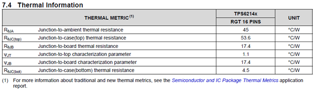

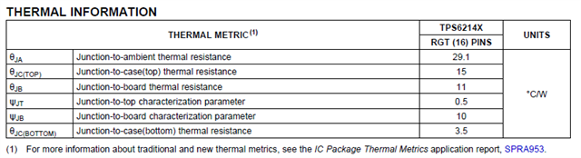

Datasheet excerpt (TPS6214X RGT (16) PINS):
© 2011 version:
θJA = 29.1°C/W
θJC(TOP) = 15°C/W
θJB = 11°C/W
ψJT = 0.5°C/W
ψJB = 10°C/W
θJC(BOTTOM) = 3.5°C/W
© 2011–2016 version:
RθJA = 45°C/W
RθJC(top) = 53.6°C/W
RθJB = 17.4°C/W
ψJT = 1.1°C/W
ψJB = 17.4°C/W
RθJC(bot) = 4.5°C/W

© 2011 version:
TJ = TC + (θJC(TOP) × Power)
TJ = TC + (ΨJT × Power)
