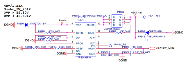

1. Please help me check the circuit. The NMOS is not working with a 48V input power supply.

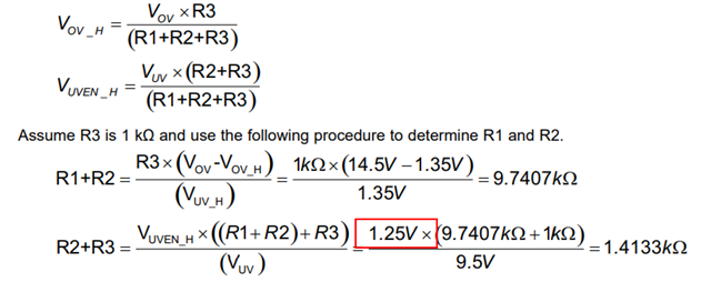

2. I also searched the forum for Vuven_h and found that it requires a 1.35V input. This is different from the datasheet.
Please make P48R7 to 10Ω.
Please check the UVLO and OVLO thresholds.
Please check the following signals during startup.
VIN, VOUT, TIMER, GATE
1.25V is VUVEN_L. Hysteresis is 100mv.
hi Sir
Questions about power trigger protection
Ilim= 50mV/ 3mohm= 16.67A
Vprog=4* (R4=10K/ (10K+R5=1.35K)= 0.475V
Plim= 0.475* 10*16.67= 79.18W
I use a load device to draw 2A, but the power protection does not trigger. How can I solve this problem?
48*2=96W> 79.18
This is an expected behavior.
PLIM = VDS x IDS, not VIN x IIN or VOUT x IOUT
PILM is used to limit the MOSFET power loss.
