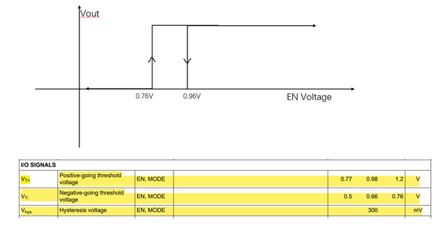

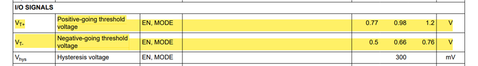

Customer is asking how many sigma for EN threshold voltage as descripted in below table?
  • Hi Beida,
    For these two specs, the mean value +/- 6*sigma is still within the min and max values.
    And out of spec units will be screened out at ATE test.
    Lei
  • Hi Lei,
    1. How to understand the Vhys and Vt+ function for Vout? Plss see below figure description.
    2. Customer test when Ven drop to 0.8V, the Vout drop to 4V from 5V. So is it normal?
  • Hi Beida,
    VT+ max 1.2V means that when the rising EN exceeds 1.2V, it's guaranteed that EN is high.
    VT- max means that when EN is falling, if it still above 0.76V, the EN is still high.
    VT- min means that when EN is falling, if it still below 0.5V, it's guaranteed that EN is low.
    I think the Vout should still be 5V if the accurate EN voltage is 0.8V.
