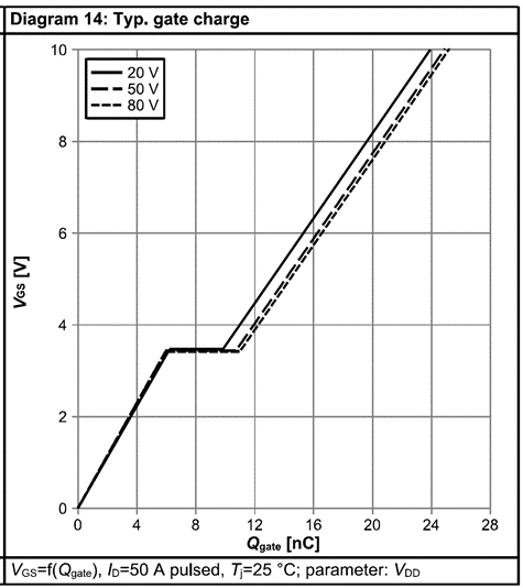

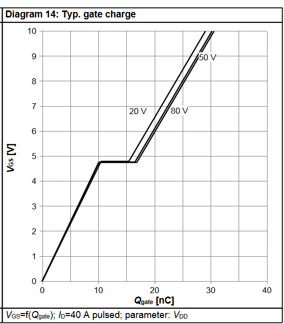

  • Hi Yuming,
    The BSC070N10NS5 is not suitable here with a 5V gate driver, as it is not a logic-level FET with Rdson rated at Vgs = 4.5V. The Miller plateau is too high, > 4V, whereas it should be ~3V. Can you use 60V or 80V FETs here? See the LM5137 EVM for 80V FET part numbers. This may also be causing the stability issue.
    Also, I recommend completing the quickstart calculator to check stability. Make sure to derate ceramic Cout with voltage.
    Tim
  • Hi Tim:
       Thank you for your reply. As you mentioned, the Miller plateau is indeed too high, so we replaced it with the ISC0805NLS. We first paralleled an 1800 µF electrolytic capacitor to the Cout, and indeed, the Vout ripple varied within the normal range.
