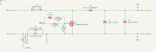

The inductor has a value of 550 µH at 10 A, shunt - 8.6mOhm(Is it very Low). I observe significant ringing in the inductor current. Currently, no snubber is applied to the IGBT switch, assuming the no-load condition would not require it. However, I suspect that the ringing might still be contributing to instability or noise-related issues.

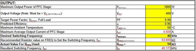

    Better yet, please provide the Excel worksheet with your design inputs.

    Thanks for the reply, I will check on the inputs you have provided, I have attached the calculation sheet, and Schematic, please verify the values and I want to let you know the V-sense is fluctuating and then it is dropping to mV during High voltage after some time, this itself making the system more unstable.
    Last time I tested while the DC bus voltage is shoot above 440VDC at 200VAC input, because the Vsense is not stable, The IC got failed none other than the Vsense pin is showing low impedance of below 20Ohm with respect to IC GND pin. (Note: I'm probing the Vsense Pin without even turning ON the IC, without IC the sensing voltage is perfect with IC it is dipping even when the IC is not turned ON)
    And with respect to Vsense resistor divider I have checked it seperately upto 450V and the divider network is providing the calculated voltage on the respective node.
    Please review these values and let me know the selected values need to be changed,

    I have attached the Excel worksheet and schematic in the previous reply,

    Sorry I was out of office for some time.  I don't see anything of major concern in the schematic design.  I think  C35 = 10000pF at ICOMP is a little high, and I suggest to reduce to 6800pF.

    If VSENSE falls to 0V and you measure ~20R to GND instead of 12.7kR, then I think the IC input is getting damaged.
    Maybe there is ESD damage during probing.
    As I mentioned before, the schematic design looks okay, so the problem must be in the board.
    Please review your PFC design on the board and make sure it is connected as the schematic shows and that the component values are as the schematic shows.
