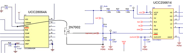

UCC25661: UCC28064A+UCC256614 PFC ON/OFF (TSET2TSET)
Part Number: UCC25661
Other Parts Discussed in Thread: UCC28064A
Can I use the TSET pin from the UCC256614 to the TSET pin of UCC28064A for disable the PFC when LLC enters into burst mode?
