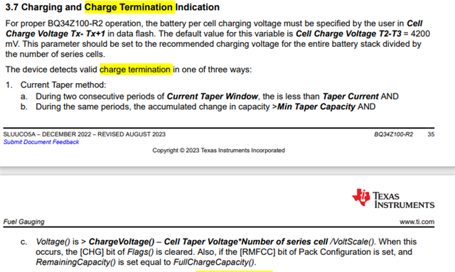

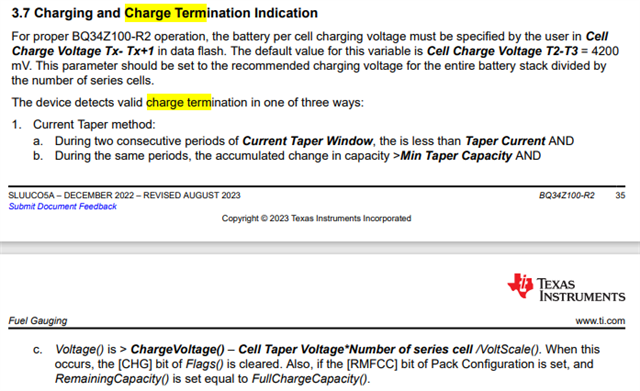

    The conditions are listed in section 3.7 in the trm. Each bolded word is a parameter.
     a. During two consecutive periods of Current Taper Window, the is less than Taper Current AND
    b. During the same periods, the accumulated change in capacity >Min Taper Capacity AND
    c. Voltage() is > ChargeVoltage() – Cell Taper Voltage*Number of series cell /VoltScale().
    When these conditions are met the FC flag will set.
    Diego
  • Hi Diego,
    I double checked the VCT conditions and started the learning cycle again. can you please answer below mentiojed questions:
    So i am using the current scaling of 10 and Energy scaling of 10, while claibrating the current, actual discharge current is 40A but I entered 4A to meet the scaling criteria.
    I also updated the CUrrent parameters accorgingly e.g
    Taper Current = 250/10=25 mA
    Quit Current = 100/10=10 mA
    Dsg Current Threshold = 500/10=50 mA
    Chg Current Threshold = 200/10=20 mA
    Can you also confirm that the Design Energy is per cell or whole block because here I am calculating the Design Energy.
    Design Energy = (20,000 x 12.6)/10 =25200 (should it be calculated cell-wise or with whole battery block is fine?)
    Design Capacity =  (200,000 mAh)/10 = 20,000

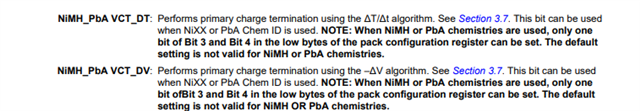

    I also disable these two flags as per TRM: NiMH_PbA VCT_DT and NiMH_PbA VCT_DV
    I also changed the Flash Update OK Cell Voltage = 1800 mV and Q_max Cell 0 = 20,000.
