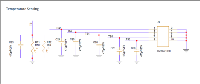

Hi Technical Experts,
I hope you are having a great day.
I am currently using the BQ7695202 AFE with an NXP MCU, and I have successfully read the cell voltages and internal temperature. However, I am encountering issues with reading the external temperature, as I am consistently getting a temperature reading of 0.
I am using a 10 kΩ temperature sensor.
I would greatly appreciate it if you could provide any sample code that facilitates the reading of data from an external temperature sensor. Such assistance would be invaluable to my work.
 This is the schematic part of temperature sensor.
And this is my init part of my code :

// Set TS1 to measure Cell Temperature - 0x92FD = 0x07
BQ769x2_SetRegister(TS1Config, 0x07, 1);
// Set TS3 to measure FET Temperature - 0x92FF = 0x0F
BQ769x2_SetRegister(TS3Config, 0x07, 1);
// Set HDQ to measure Cell Temperature - 0x9300 = 0x07
BQ769x2_SetRegister(HDQPinConfig, 0x0B, 1); // No thermistor installed on EVM HDQ pin, so set to 0x00
BQ769x2_SetRegister(CFETOFFPinConfig, 0x03, 1); // No thermistor installed on EVM HDQ pin, so set to 0x00
BQ769x2_SetRegister(DCHGPinConfig, 0x0B, 1); // No thermistor installed on EVM HDQ pin, so set to 0x00
BQ769x2_SetRegister(DDSGPinConfig, 0x0B, 1); // No thermistor installed on EVM HDQ pin, so set to 0x00
