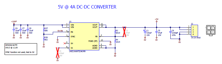

The device is designed to provide a regulated 5V supply from a fixed 24V DC input (provided by a separate AC/DC PSU).  The circuit is shown below:
R3 and R4 provide feedback to give an output voltage of 5V.  R27 and R28 provide an enable signal that ensures regulation only starts when VIN is >11.6V.
C1 and C5 provide the necessary output capacitance, C1 is Kemet part T520Y337M010AHE015 and C5 is Kemet part C1210C476K8RACTU.
All resistors are 1% tolerance.

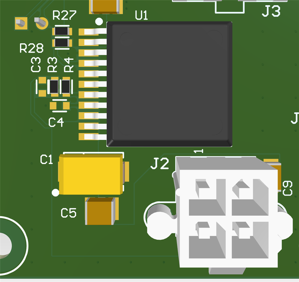

    Can you also share the layout?
    Is the device properly soldered to the board?
    Ridge

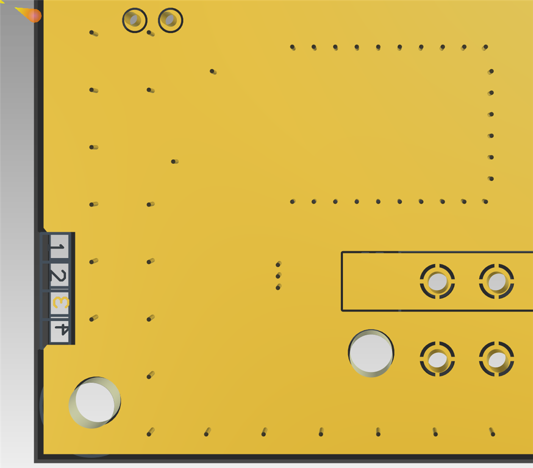

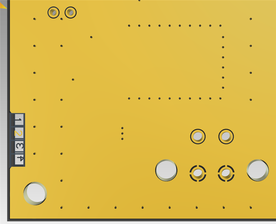

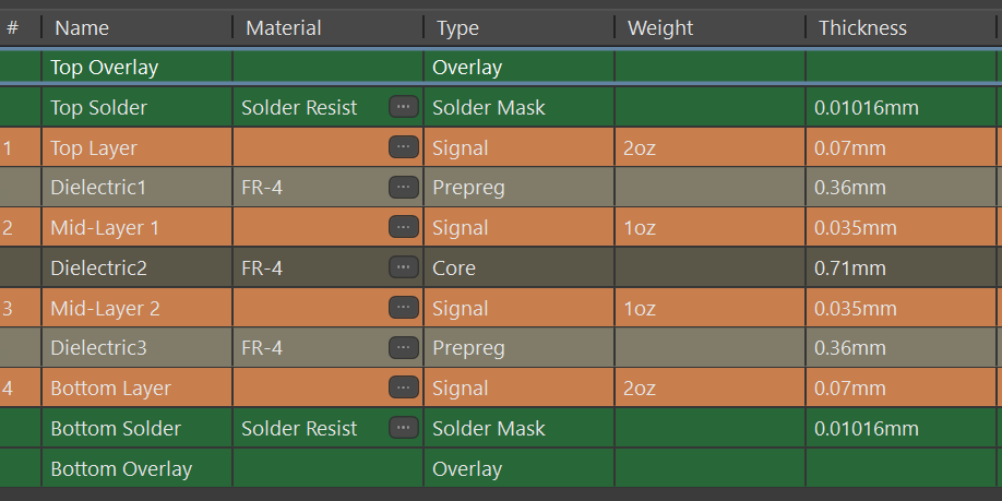

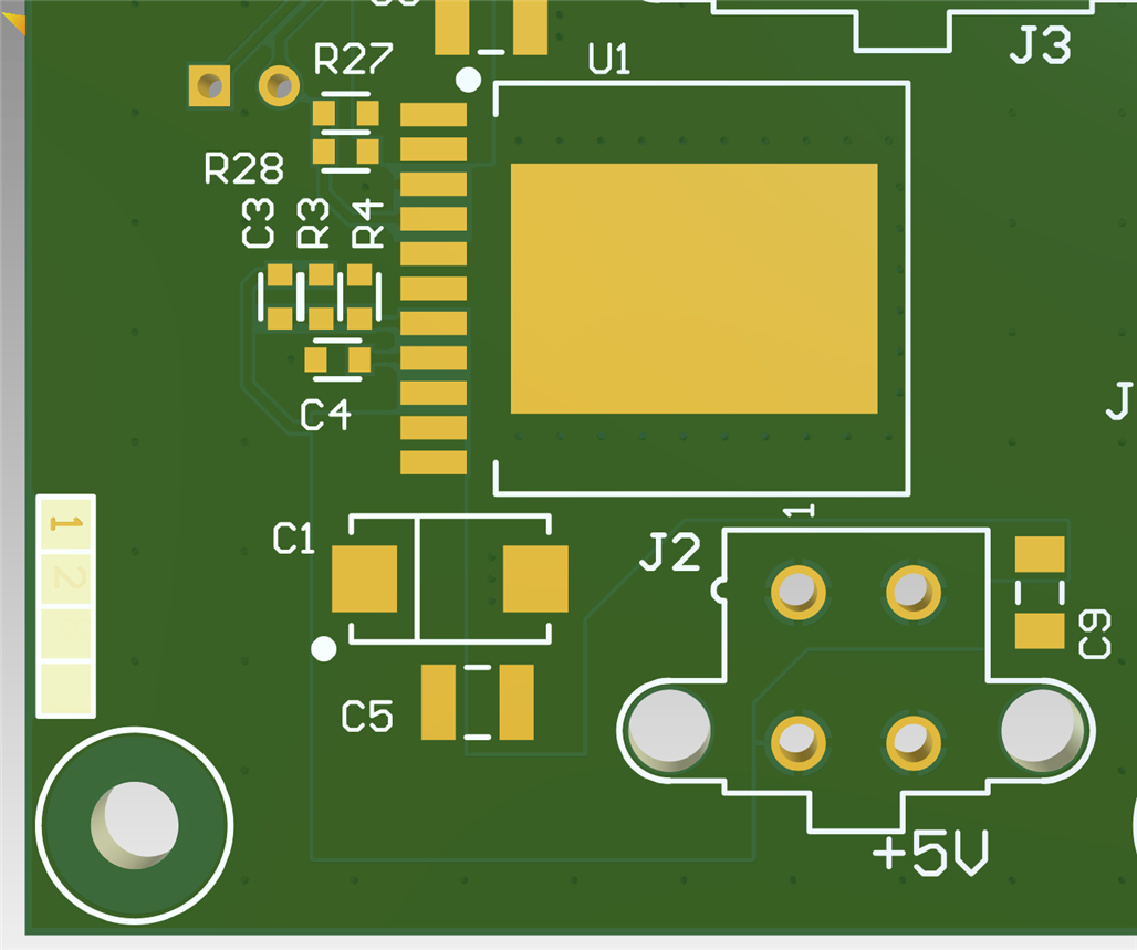

  • I cannot share the whole board layout.  I have attached some screenshots from the CAD.  This is a four layer board with 2oz copper on outer layers.  The idea is to conduct as much heat into the copper and radiate that away into the enclosure.  Our max ambient operating temperature for the product is 40C, the unit that failed was never operated in more than 25C.
    Stack up:
    Components - Top layer.
    Top Layer with no components (showing pads - paste mask is equivalent).
    Top layer copper.
    Inner layer 1 copper (GND):
    Inner layer 2 copper (GND):
    Bottom copper layer (GND):
