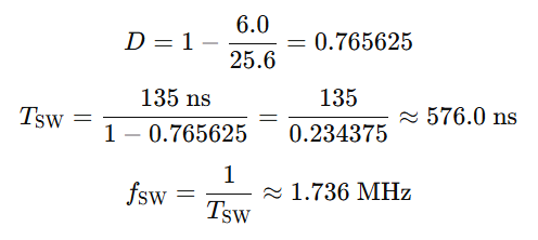

I'm designing a Boost LED driver using the TPS923652, and I would like to confirm that my chosen switching frequency is safe with respect to the controller’s minimum off-time requirement.
Design specification:
  • VOUT: 25.6 V
  • VIN range: 6.0 V to 8.4 V (2S Li-ion)
  • Minimum off-time (datasheet): 100 ns
  • Design margin on Toff: +30% → 135 ns minimum used in calculations
To ensure I'm within safe operating limits, I computed the required switching period from the off-time constraint using the formula:
Using the worst-case condition (highest duty cycle at VIN = 6.0 V):
So, to maintain a 135 ns minimum off-time, the maximum safe switching frequency should be ~1.74 MHz.
With Rfset = 18kOhm I choose 1.5MHz.
My questions are
  1. Can you confirm that this reasoning is valid and that the calculations are correct?
  2. Is there any additional timing margin you would recommend (e.g., more than 30%) to account for internal tolerances or variations?
Thank you for your support.
Thomas

  • Hi Thomas,
    For the selection of the switching frequency, besides the minimum off time, another thing that should take into consideration is the thermal performance:
    (1) Switching frequency: For your calculations, they are almost good, but one thing need to mention here is that the duty cycle is also be related with the efficiency. In ideal case, D=1-VIN/VOUT; However, actually D=1-VIN*Eff/Vout. For example, you can use 80% as a start point. For the min off time margin, there is no high limit data here. I would suggest you can leave +100% margin to ensure good operation.
    (2) Thermal performance: Different switching frequency will result in different switching losses. And the thermal performance will also be related with different copper thickness, layout and vias. Thus, I would recommend you can first check with TPS923652EVM board and also verify with your board.
    Thank you!
    BRs
    Lucia
  • Hi Lucia,
    Sorry for the late reply.
    I have updated my calculations by taking into account the efficiency and the +100% margin as you suggested.
    I also noted your comments regarding the thermal performance considerations.
    However, I haven’t received feedback yet regarding the diode selection from my previous message. Could you please confirm the main parameters to consider?
    In addition, I would like to confirm if it is acceptable to directly connect the VCC pin to the EN/PWM pin in order to indicate analog PWM mode.
    Finally, would it be possible to request a schematic review once my design is completed?
    Thank you again for your support.
    Thomas
