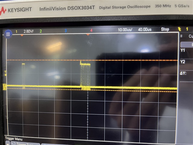

    Problem statement:
    The TPS59641RSLT is not generating the VCC (CPU) channel voltage, although the VNN (GPU) voltage of 1.1 V (VBOOT) is being generated on one of our 20 custom boards. We have recently encountered this issue; earlier it was working as expected.
    To debug this, we have followed these steps:
    1. Replaced inductor L56 and output capacitors – no improvement.
    2. Disconnected the load (processor supply bank) from the source VRM – no improvement.
    3. Checked the circuitry and component values on CF-IMAX, CIMON, CTHERM, COCP-I, and CCSP1/CCSN1; also replaced the components – no improvement.
    4. Verified V5DRV and other 3.3 V/5 V input supplies – all okay.
    When probing the CSW1 pin of the VRM, I observe square waves (5 V amplitude) for a short duration (approx. 60 µs).
    Similarly, probing the VSW pins of the power MOSFET (U138) shows the same square wave pulses for the same duration.
    However, there is no output voltage spike on the VCC_DCD0 power nets.
    I suspect this may be due to an overcurrent error, UVP, thermal error, or some other fault condition. To investigate further, I probed the CIMON pin and observed a 1.05 V spike for a short duration, which could indicate an overcurrent condition—even though no load is connected.
    Attached are the CSW1, VSW, and CIMON waveforms for your reference.
    I kindly request your help in diagnosing and resolving this issue.
    Raj
  • Hi Raj,
    From your observations ,It gives an impression like the feedback from output voltage is not reaching the TPS59641. Please can you check the feedback  network. Also can you check the voltage level on switch node, if you are getting some pulses on switch node there should be some raise in the output voltage. Please give us sometime to go through this issue , this part is a very old part..
    Chanakya.

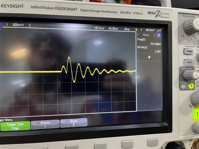

  • Hello Chanakya,
    Thank you for the response.
    I have checked the continuity on feedback pins "CVFB" & "CGFB", and it okay. There is nothing much in feedback path except the 10-ohm series register.
    Additionally, I have replaced the components in current sense circuit "CCSP1" and "CCSN1". It didn't solve the issue.
    Since, we are getting the 5V pulses on VSW pins of MOSFET for short duration, Ideally we should have get some voltage buildup. but a few days back, we observed this kind of waveform on the output stage. refer to the below image- (this is the VOUT when load is disconnected)-
    Thank You
    Raj Kumar
  • Hi Raj,
    Please can you probe VOut and switching node together
    Chanakya.

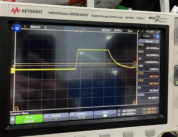

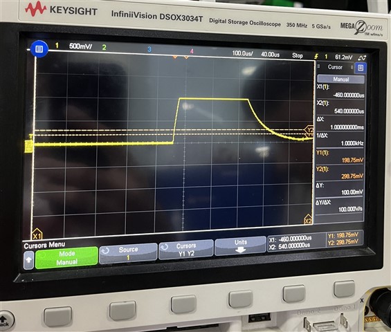

  • Hi Chanakya,
    Swapping the IC is not easy due to the high board density.
    I have an observation:
    When I probed the CIMON (CPU Phase Current Monitor Pin), it showed a logic high for about 250 µs. Is this normal behavior, or does it indicate a high current issue during startup or some other error?
    Please refer to the attached waveform for reference.
    Raj
  • Hi Raj,
    Swap test is important to identify if it's the board issue or device issue. As this part is designed 15 years back in TI, we have limited information on this part, doing swap test will help us a lot in debug.
    Please plan to do the swap test, meanwhile I will collate the information in e2e regarding the issue and check with my team members.
    Chanakya.
