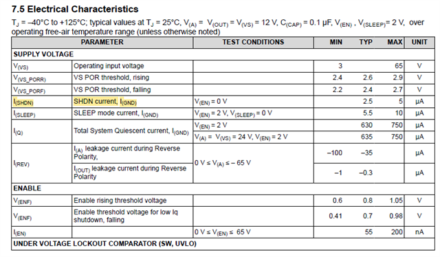

What is "I(SHDN)" / SHDN current?
What stadns for "SHDN"??
See more details on the attachment;
Hi Miyazaki-san,
The ISHDN means the shutdown current. This is the current consumed by IC in off state. (When EN=0)
