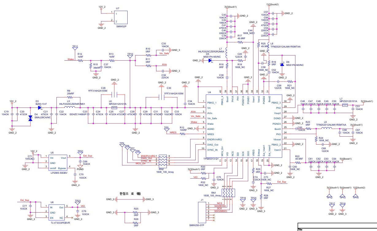

I would like to ask a follow-up question regarding the TPS65313-Q1, which I am planning to use as a PMIC in my design.
Previously, I suspected that the issue was caused by providing only 5V to the WAKE pin, but I have since revised the circuit to ensure the WAKE pin receives approximately 11.5V (as measured with an oscilloscope). Despite this, I still do not observe any output from Buck1, Buck2, or the Boost converter — i.e., no 3.3V, 1.2V, or 5V outputs.
I designed my custom board based on the schematic provided in the EVM kit datasheet. However, I am unsure why the regulators are not turning on.
From what I can tell, there seems to be no switching activity at the Boot1 output, and I cannot identify the reason for this behavior.

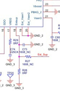

Since I do not plan to use any external power source, I connected Ext_Vsen1, Ext_Vsen2, and Extsup to GND — just as shown in the EVM when those functions are unused. However, this setup still does not result in any output voltages, and I am also not observing any waveform on the VREG pin.
I would greatly appreciate your support in identifying what could be going wrong.
I will attach my schematic for your reference.
Please note that this setup is intended only for testing the power outputs, so the MCU is not connected to the board.
SPI communication is also not connected.
Pins 7 to 11, as well as all SPI-related pins, are left unconnected.
As mentioned earlier, I designed the schematic by closely referencing the TPS65313-Q1 EVM kit.
It should be nearly identical to the EVM.
If there is anything incorrect or missing in my implementation, I would greatly appreciate your advice or suggestions.

  • Additionally, I am supplying 12 V to the AVIN pin, but the VREG output remains at 0 V — even under conditions where the internal LDO should be active.
    I also tried supplying 5 V to the EXTSUP pin, but the VREG output still does not appear.
    This seems to be the core issue preventing the device from powering up properly.

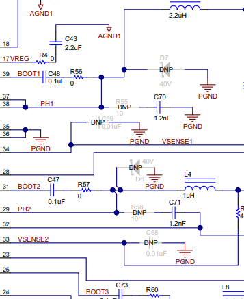

  • Hi Lee,
    While reviewing the schematic, in EVM schematic, the diodes on the switch are not populated.  can you check that and try to un-populate those.
    Ishtiaque
  • Thank you for response.
    I have confirmed that the diodes are not mounted on the board I manufactured, as indicated by DNP on the EVM. The diodes are unpopulated, yet under these conditions, no voltage is output.

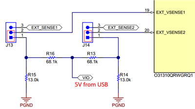

  • Hi Lee,
    Upon reviewing the schematic and comparing to EVM, I find following discrepancies.
    1. Ext_Vsense1 and Ext_Vsense1  are Grounded in your schematic whereas in the EVM schematic these are supplied 0.8V from VIO via voltage resistor divider.
    2. EXT_SUP in your schematic seems to be connected to GND. This should be connected to Ext_sup  5V but I think as far as I can read your schematic the R27 seems to be NC. IF that is the case then I think as per EVM schematic this should be populated and R28 should be NC.
    Ishtiaque
  • Thank you, Ishtiaque,
    According to the datasheet, for the Ext_Vsense1, Ext_Vsense2, and Ext_Sup pins, if they are not used, they should be tied to GND. I have confirmed from the datasheet that if the Ext_Sup power is not used, the internal LDO is configured from the AVin voltage to generate Vreg. Since my intention is not to use Ext_Sup 5V, I believe connecting it to GND is correct.
    Regarding the EVM, it also operates internally even without supplying Ext_Sup 5V. Therefore, it seems that Ext_Sup is not currently relevant. Is it mandatory to use an external power for Ext_Sup?
    Additionally, for the prototype board, I have already applied 5V to Ext_Sup, but the symptom remained the same—no voltage output was observed.

    Since you are using the same OPN (O31310QRWGRQ1) as used on the EVM so you need to provide those external sense voltages  because it could be so that in the device NVM, those two external_vsense pins are configured to monitor the voltages and if you do not provide, the device may consider as fault and does not power. If you do not use in your application then you may need to modify those settings in the exiting NVM or ask for custom OPN which then can be reprogrammed as per your application use case.
    To my understanding both above things are necessary. It doesn't hurt trying that since you are exactly copying the EVM design so you need to follow the EVM instructions for PMIC power up.
