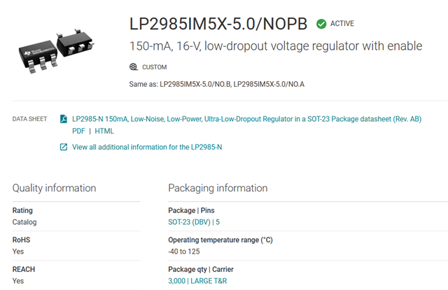

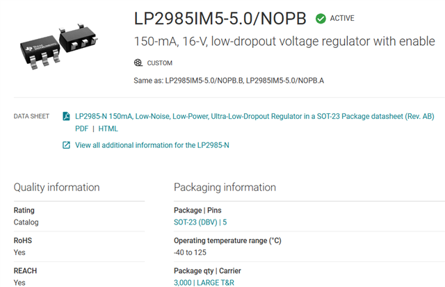

Based on comparison the spec seems the same, however, there is a packaging “X” indication but no exact info.
LP2985IM5-3.0/NOPB vs LP2985IM5X-3.0/NOPB
Could you explain what is the suffix “X” meaning?
Nur,
The "X" is usually used to differentiate between large reel and non-X being small reel. However, for this device we don't have a small reel, so there is no difference.
Prakash L
Hi Prakash , thanks for the reply. I do have concern, whether the big carrier type may not suit with our SMT manufacturing machine. Can i request the different and perhaps any illustrate by drawing and photo to take a look at large reel
Nur,
There is no difference between the 2 devices here.
Page 36 has the package reel information in the PDS.
Prakash L
