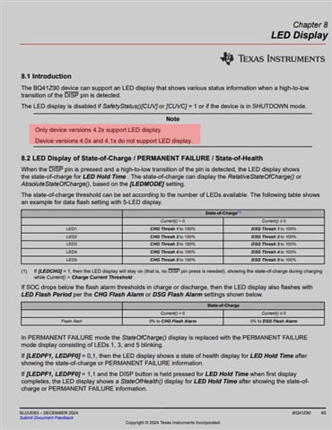

I am currently working with the BQ41Z90 fuel gauge IC using the BQ41Z90 EVM (BMS081 Rev A). According to the Technical Reference Manual, only device versions 4.2x support LED display functionality.
I would like to confirm the exact version of the IC installed on my board.
