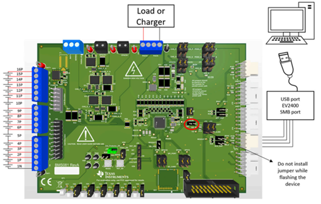

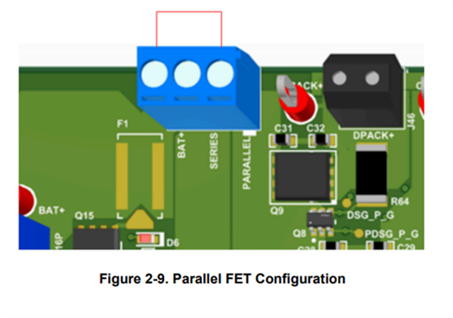

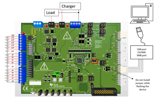

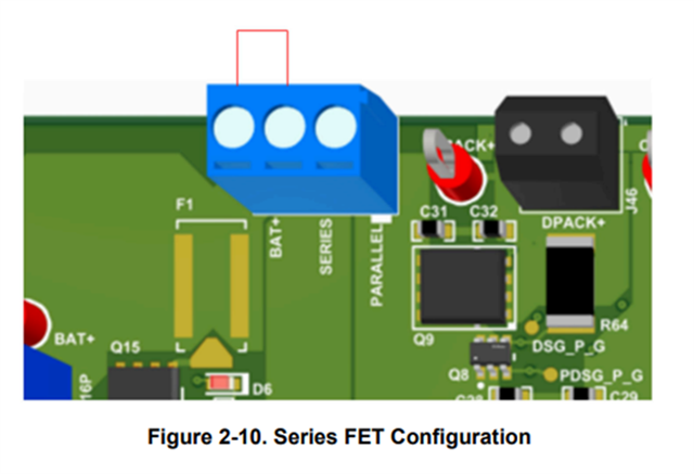

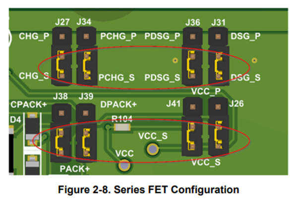

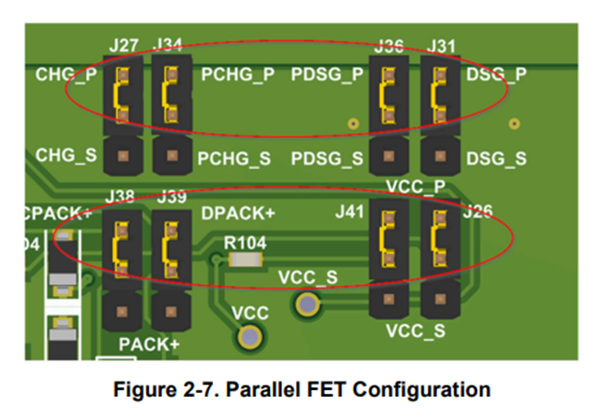

    I have not had a chance to test your configuration yet. However, here are the complete steps to close the FETs that have helped many customers.
    Board set up
    Series
    Parallel
    BQstudio settings
     FET_EN = 1
    This can be toggled with the FET_EN cmd on the right

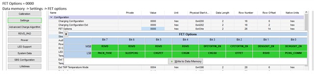

    FET Options = 0000
    Data memory -> Settings -> FET options
    NR=1
    Data Memory -> Settings -> DA configuration
    Disable Protections
    Make sure all protections are disabled, all protections should =0, notice some bits are rsvd, these can be left as is. These bits are described in the TRM.
    Diego
