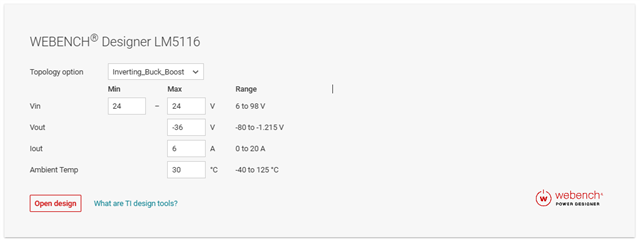

Plesae kindly check if LM5116 can support input voltage 24V and output voltage -36V and output current 6A circuit, if yes, can you provide the comment how to design? Thanks.
  • Hello Zhang
    Yes, the device can support your application. Please use the WEBENCH in the product folder https://www.ti.com/product/LM5116 and select 'Inverting Buck-Boost' topology option.

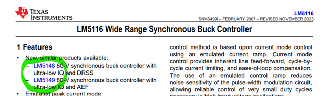

    If it is not too late, please consider using LM5148 or LM5149 which offers reduced BOM cost, higher efficiency, and reduced design size and many other features.
