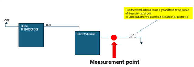

We are currently evaluating the TPS16630RGER in our system for output short-circuit protection.
Please find below our circuit design conditions and test results.
■ Design Conditions
  • Input Voltage: +V1F = 42V
  • UVLO Threshold: 28.9V
  • OVP Threshold: 49.1V
  • ILIM: 4.7kΩ → 3.83A
  • Inrush Capacitors Total: ~909.4 μF
  • MODE: Open (latched off after overcurrent)
  • IMON Setting: 3.83A × 27.9 × 30kΩ ≒ 3.21V

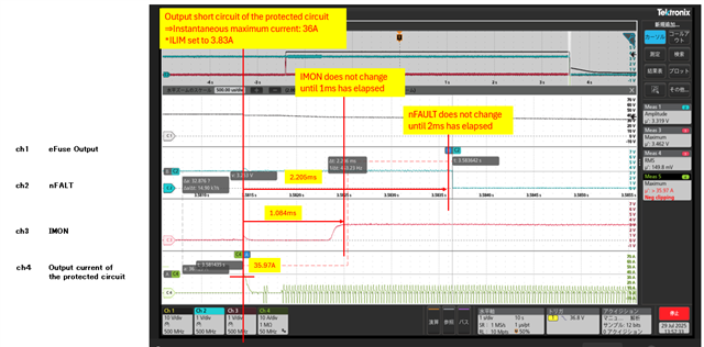

■ Observed Behavior During Output Short Test
  • Peak current of approx. 36A occurs instantly after the short, far exceeding ILIM
  • IMON output responds approx. 1ms after the short
  • FLT_n asserts LOW approx. 2ms after the short
■ Questions
  1. Is there any way to reduce the instantaneous peak current before the fast-trip circuit activates?
    Although ILIM is set to 3.83A, nearly 36A flows momentarily during the short event.
  2. Is there a way to shorten the response time from output short to changes in IMON and assertion of FLT_n?
    According to the datasheet, fast-trip delay is ~1μs, but actual IMON and FLT_n response is 1–2ms.
    We would appreciate any advice on possible ways to minimize this latency.
