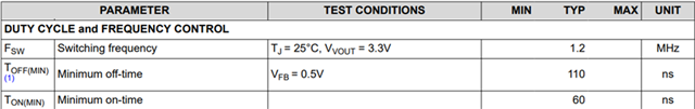

Hi team,
There is no description about MAX value of Ton(min).
What is the value of this?
Is it safe 60ns on-time with 1.2MHz Fsw?

Hello Goto,
We only provide the typical Ton(min) time in the datasheet.
so, you can consider the min Ton time to be 60ns typical with 1.2MHz.
Let me know if you need any other help on this.
-Hitesh
Hi Hitesh,
Thanks!
BTW, Fsw doesn't have also specific Fsw MAX value, does it?
Goto
Hello Goto,
please refer table 7-1 in datasheet for frequency details.
TPSM86325x 3V to 17V Input, 3A, Synchronous Buck Module in QFN Package datasheet (Rev. C)
-Hitesh
Hi Hitesh,
Thank you.
Now I understand that the device can be driven at 2MHz in some cases.
What I want to know is how varied TYP1.2 MHz is.
Goto
Hello Goto,
Fig.6-18 can help you checking frequency for specific loading condition but these will be typical conditions, unfortunately we don't have data for variation in frequency.
