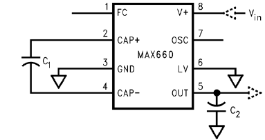

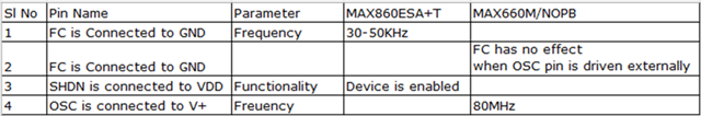

If max 660 PIN No 7 OSC is connected to V+ what is the effect will occur. This is the understanding i got from the datasheet is this correct

If OSC is up connected to V+, the frequency is set around 80kHz.
