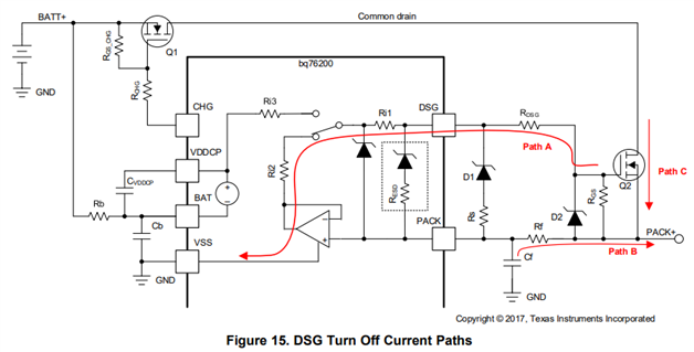

1. We have questions regarding the current path during DSG Turn OFF.
a. We are looking at Fig. 15 in BQ7200 : beyond the simple app. schematic. What is the current path after passing through RI2.

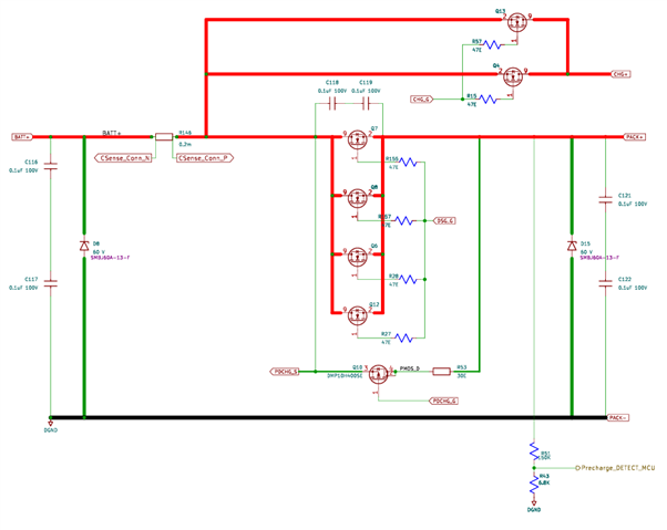

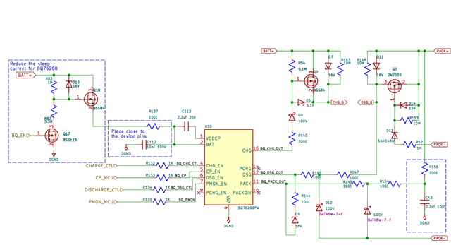

b. We are using 4 MOSFETs in parallel with Input capacitance of 21500pF each ( Max ). We would like to reduce the DSG Turn OFF time to <30 microseconds. ( We are currently 90 microseconds ).   We would like to know how we could tune the circuit to reduce the turn OFF time. ( Schematic below )
Gate Driver Schematic Image
Power Path Image
2. We would like to know if the selected components work for reducing the current consumption of the gate driver.  ( Gate Driver Schematic Image
