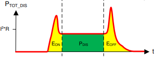

Hi Shunsuke,
For power dissipation, please use P = I^2 x RON. Also, consider the switching losses during turn on and turn off.
Please see section 2.4.1 Power Dissipation Calculation in the following application note - How To Drive Resistive, Inductive, Capacitive, and Lighting Loads (Rev. E).

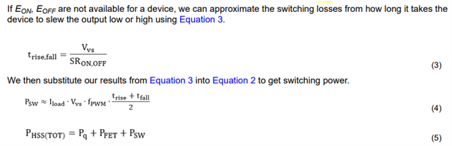

Hi Yamamoto-san,
1. INOM is the typical load current for your system.
2. Yes, we will consider this, sorry for the confusion.
3. Since EON/EOFF are not specified in the datasheet, please use the following equations from section 2 Device Thermals in the Driving PWM Loads with TI High-Side Switches application note.
Rishika Patel
