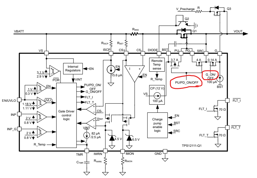

In normal operation, they will apply HIGH signal(approx. 3.3V) at EN/UVLO pin from MCU to turn-on FET.
Once TPS1211-Q1 detect fault, MCU detect this fault event and drive EN/UVLO to Low.
However, their MCU's LOW level approx. 0.4V which is higher than VENF(0.3V) so I'd like to make sure just in case.
In this condition, LOW signal from MCU is still lower than VUVLF(1.1V) so TPS1211-Q1 turn-off FET.
However, Low signal is higher than VENF so we cannot guarantee this device enter low Iq mode.
Is this understanding correct?

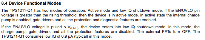

  • Rishika-san,
    Customer's expectation is to completely shutdown TPS1211-Q1 once fault is detected.
    The datasheet said above UVLO threshold cause turn-on device completely(charge pump, GD, protection, diag)
    Also Lower than EN cause shutdown device completely.
    However, there isn't device mode description between lower than UVLO and higher than EN.
    Then, could you please tell me how work this device during this condition?
    Kazuki Kuramochi

  • Hi Kuramochi-san,
    In order for the low IQ effect to be in place, VEN/UVLO<V(ENF). If not, the device will be considered in active state, but the gate driver section will not be activated because it has not met the V(UVLOR) threshold so it should require around normal IQ.

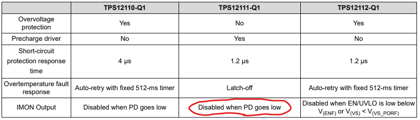

  • Hi Rishika-san,
    Thank you for your confirmation.
    I'd like to dig into more about V(ENF)<EN/UVLO<V(UVLOF) condition.
    In this condition, are you saying PD/PU_OFF and G_OFF happen?
    Also, how about IMON?
    Datasheet said TPS12111-Q1 disable IMON during PD_OFF but block diagram seems it need to be lower than V(ENF).
    Also, is there any other feature or function which will be disabled by V(ENF)<EN/UVLO<V(UVLOF)?
    In other words, PD/PU_OFF and G_OFF are only event which is caused by V(ENF)<EN/UVLO<V(UVLOF)?
    Kazuki Kuramochi

  • Hi Kuramochi-san,
    I checked with our systems engineer and for this in-between condition, some circuitry may be on and some may be off. We cannot guarantee which blocks will be on versus off because generally speaking this is just a range - V(ENF)<EN/UVLO<V(UVLOF), we would need to know the exact value of EN/UVLO. So, the IQ will be slightly lower than the active mode IQ during this condition.
    Rishika Patel
  • Rishika-san,
    Below is my understanding summary for the device behavior during V(ENF)<EN/UVLO<V(UVLOF).
    Is this correct understanding?
    1. PD/PU pin and G pin will be Low(short to SRC) or Hi-z.
    2. Some internal block may be on or off. we cannot guaranty what block will be on or off.
    3. So Iq may be fluctuated.
    4. However, Q1 and Q3 should be off and VBATT will be disconnected from VOUT side regardless of internal block condition due to the status of 1..
    Kazuki Kuramochi
  • Hi Kuramochi-san,
    Yes, your understanding is correct. When EN/UVLO is low, the charge pump is off and CBST is not charged so the gate will not have enough voltage to turn the FETs on.
