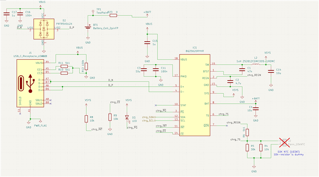

Hallo,
I have a BQ25620 running and control it via a linux computer.
It works fine except:
  • it does not charge the battery, it just powers the system (via battery or via VBUS, if available)
  • VBUS stays high after unplugging the USB charger; when I enable EN_HIZ, then USB voltage drops to zero (charger not plugged in).
I was able to verify all ADC values using lab measurement equipment.
19:07:13 - Charging (CC/Pre), IBUS: 392 mA
19:07:13 - Charging (CC/Pre), IBAT: 16 mA
19:07:13 - Charging (CC/Pre), VBUS: 5054 mV
19:07:13 - Charging (CC/Pre), VPMID: 5050 mV
19:07:13 - Charging (CC/Pre), VBAT: 3611 mV
19:07:13 - Charging (CC/Pre), VSYS: 3621 mV

  • 02: after plugging in a charger. Charger means Vcc + GND on Lab Power supply, D+ and D- shorted. I can see the VBUS voltage, but I ould expect a high (>1A) charge current. My power supply shows 200mA@5.2V
  • 03: after unplugging the charger - VBUS stays at VPMID level. I could clear it by setting EN_HIZ =1 for a short time
The schematic is attached as screenshot.
Any help or tips appreciated.

  • Hello Markus,
    Thank you for reaching out via E2E. Please see my comments below.
    Firstly, I do not believe this relates to your issue of not being able to charge, but TI recommends a minimum of 20uF output capacitance be placed at SYS. Your schematic diagram appears to only show a 10uF capacitor at buck converter output. Additionally, you should have a current limiting resistor in series with your LED connected to /PG pin. TI recommends at least 1kohms.
    I recommend we debug one issue at a time, so I will focus on not charging issue first then we can shift focus to your observation of voltage remaining at VBUS after unplug.
    Review of the register logs show that once input adapter is connected device is in charging status, but also IINDPM status (input current regulation). Reaching the input current limit would explain why charge current does not reach expected 1A, but with that said current draw from your power supply appears significantly lower than the 1.5A input current limit.
    With this in mind I have a few follow-up questions:
    -Can you try writing REG0x06 to a higher value to check if it will result in higher charge current? Can you also double check that IINDPM is in fact set to 1.5A at time when device is in INDPM status (REG0x1D[3])?
    -What is your expected SYS load during test and do you by chance have any current load connected at PMID pin?
    -Do you happen to have multiple boards (or a replacement BQ25620 unit) you can test with and can you see same observation on the alternate board?
    Garrett
  • Hallo Garrett,
    Thank you so much for your your reply. I really appreciate your help.
    VSYS feeds a boost converter (TLV6170), which has a 47µF + 10F Input capacitance, so the total output capacitance is 67µF.
    The LED I put for debugging (in the board where I extracted the data for this post). In the real design, I have a 10k pull up resistor (to VSYS). This did not change the behavior.
    I have tested three different boards, they all behave the same.
    I started the testing as you suggested: Battery and charger plugged in:
    Register 0x1D reads 0x08 which indicates "In IINDPM/ILIM regulation or IOTG regulation".
    Register 0x06 reads 0x04B0 (1500mA, set by the IC).
    - setting 0x06 to 0x04B0, I get 200mA current draw on my bench supply. (the 1500mA set by the chip)
    - setting 0x06 to 0x0960, I get 300mA current draw on my bench supply. (the recommended test by you)
    I am able to verify the voltages/currents with the ADC of the BQ25620. They align with what I expect/set.
    The circuit (system load) takes around 200mA. I don't understand, why IINDPM status is set.
    I did review the PMID connections (schematic, layout, microscope), they are looking fine. It is only two capacitors, routed on top layer. I don't see how there could be a leak to somewhere else.
    Markus
  • Okay, nevermind.
    I had a BOM-mistake: The 47nF cap between BTST and SW was actually 47pF. That solved all issues.
    Thanks for the support
  • Hi Markus,
    Thank you for the response. Glad to hear your issue was resolved by changing to properly sized bootstrap capacitor.
    Garrett
