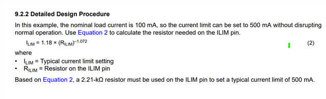

Dear Team TI,
from the TPS22950CQDDCRQ1 Datasheet, a snapshot of 9.2.2 Detailed Design Procedure section is below. Here if we calculate for RLIM, considering ILIM=500mA, we end up getting 2.22 ohm and not 2.21 kilo ohm from the given equation (2). Can you please confirm whether should the calculation result be considered in kilo ohm or it is a typo in the datasheet.
Even in section 6.5 electrical characteristics for Output current Limit, the RLIM values are matching for the given ILIM's typical values without kilo ohms in resistor units after calculating for RLIM for their respective ILIM's using equation (2) from the section 9.2.2 Detailed Design Procedure.
Can you please clarify whether kilo ohms should be considered with the unit ohms?
Thank you. I'm anticipating for a quick response.

  • Hello Srujan,
    If you take RILIM 2.21 you will get 0.5A which is 500mA.
    RILIM unit is KoHms and ILIM is in amps.
    So, in formula put 2.21 in place of RILIM.
    Amrit
  • Dear Amrit,
    So I understood that I have to use 2.21 Kohm resistor in my design to limit a current of 500mA.
