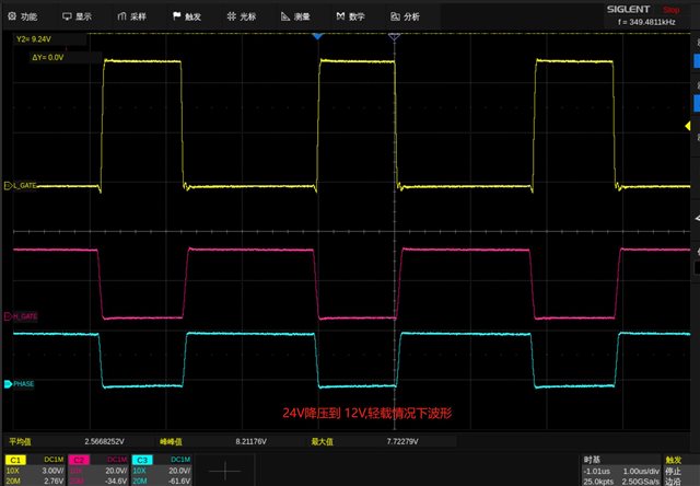

2. The ligh load for 12V output voltage

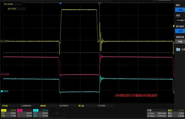

3. The 6A output current load:
4, The yellow line is L_gate, the red line is H_gate, the blue line is SW1 line;
