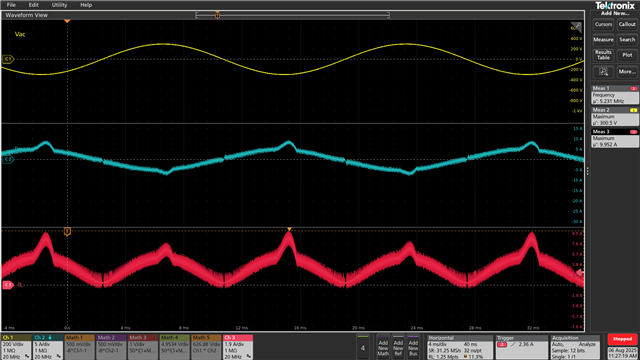

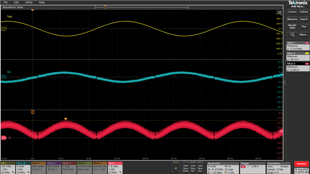

I am currently working on a 1000 W Continuous Conduction Mode (CCM) boost PFC design using the UCC28180 controller. The circuit performs well at light to medium loads, maintaining a power factor (PF) of 0.99 up to approximately 700 W. However, as the output load increases beyond 750 W, I observe a gradual drop in PF to around 0.95.
Upon probing the waveforms with an oscilloscope, I noticed that both the inductor and input current waveforms begin to show peaking near the AC line voltage peaks. This distortion seems to coincide with the observed drop in PF.
To support this observation, I have captured and arranged waveforms chronologically at increasing output loads of 1.9 A and 2.25 A.

Iout=1.9A
Iout=2.25A
  • Hi Sourov,
    As the load increases, the ICOMP voltage also increases. If the ICOMP voltage hits the upper limit of 6V, this situation can occur. Please check the ICOMP pin voltage to confirm that. And if this is the case, then reduction in the Rsense resistor by half should solve this problem.

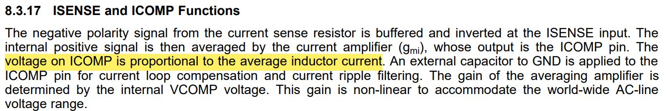

  • Hi Sourov,
    Please check the following highlighted statement in the UCC28180 datasheet:
    At higher Rsense the sensed value of inductor current is higher and ICOMP voltage tries to get adjusted to that higher value. Then if the load also increases, the inductor current also needs to increase causing the ICOMP to increase and eventually it gets clamped to the maximum value (6V). That is why if a lower Rsense is used, at same loading condition the sensed inductor current would be less and the ICOMP voltage also would be lesser.
