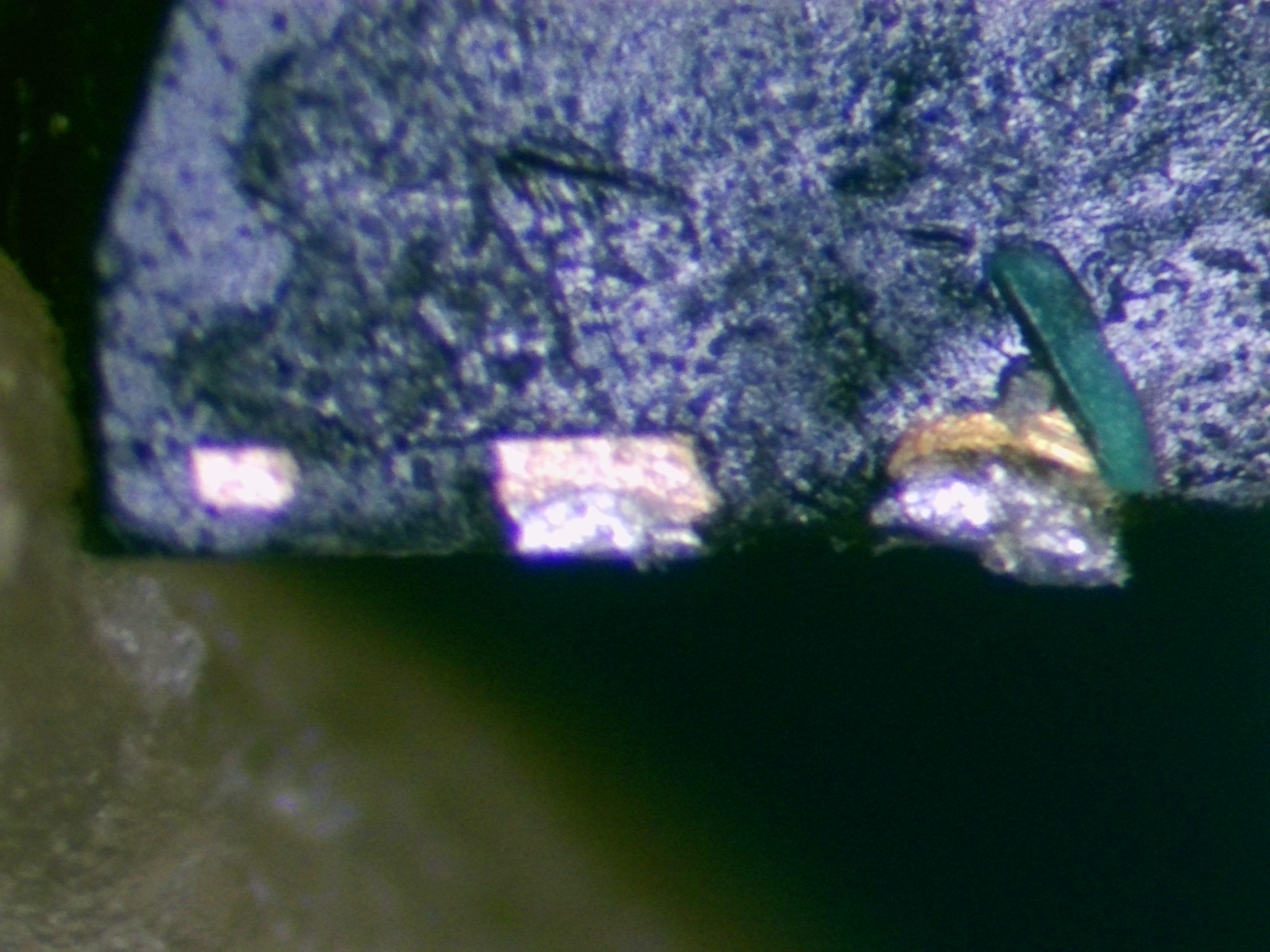

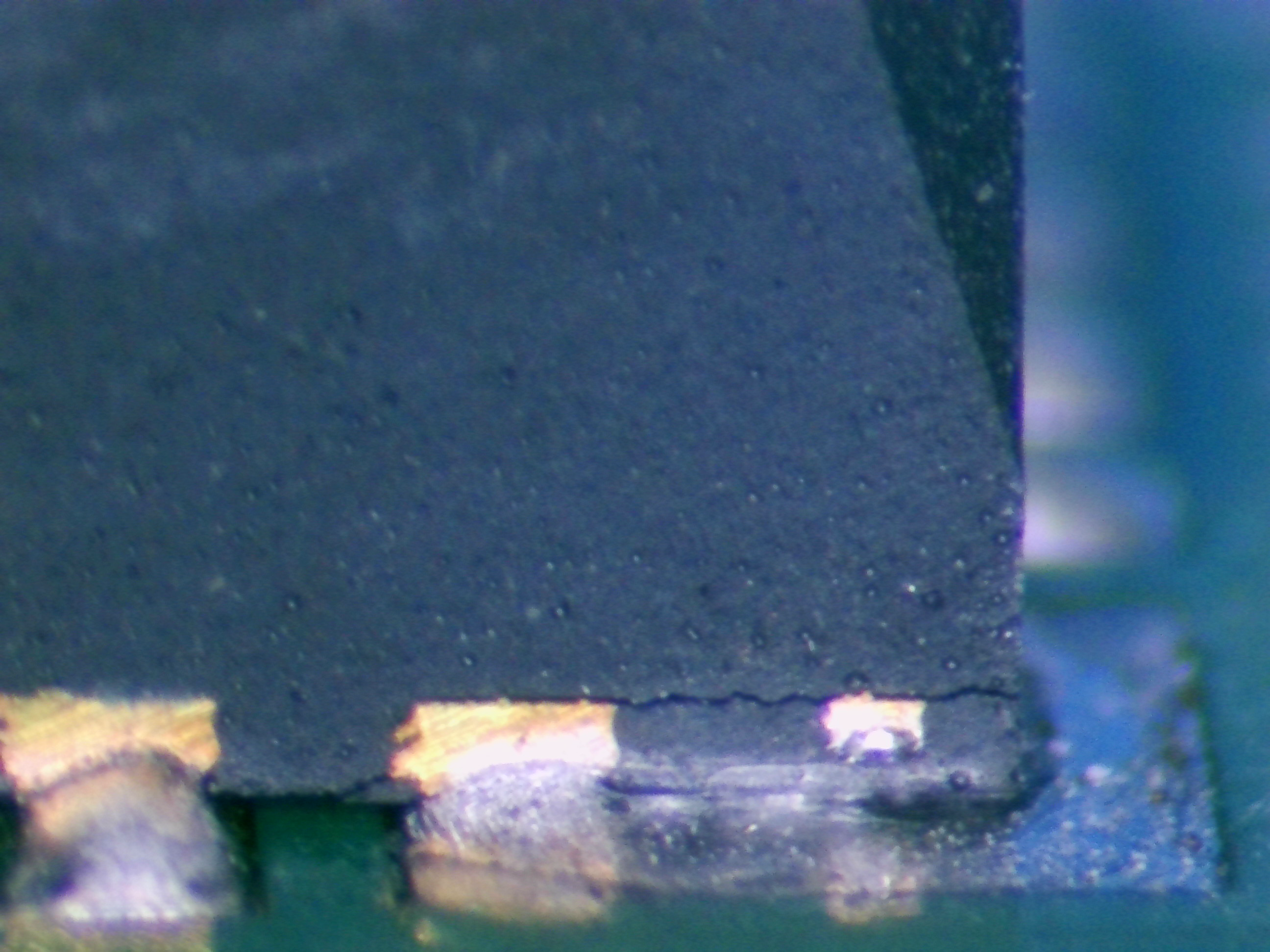

Several TPS84A20RVQT devices have failed in the field with low output voltage. We have found some devices have hairline cracks between the pin 7 metalization and the package (see images below) and others have at a failed solder joint at pin 7. Is TI aware of any cause for these types of failures?

    can you help me understand at what conditions that this occur on your application, is there any stress on the part , pictures you show is near a corner pin . so need more information from you to better understand and address .
    This looks like a reflow stress and modules are more sensitive than ICs while reflow

    We are investigating possible mechanical impact and deflection near this location of the PCB. Please provide more information regarding possible reflow issues.  Note: The PCA is assembled per MSL 3.

    Make sure you are following the EVM layout guidance and are not doing something that might add extra stress on the device pins.
    what is the use case. Is the PCB potentially flexing in the application? How long have the parts worked in the field until this issue came up?
    If you are using the standard MSL3 guidelines it is probably fine but I would verify their reflow temp does not go above 245C. Even though the reflow profile is MSL3, we specify 245C due to the package height.
