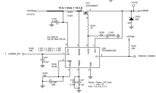

Hello Team,
Greetings !!!
We are using "TPS2490DGSR" in our design for limiting the current for brakes. Attached the snap of the circuit for reference.
To address the EOL, the MOSFET Q13 is replaced in the latest revision from FDB024N06 (Fairchild) to STB100N6F7 (ST Microelectronics).
Now while testing , the short circuit behavior is drastically changed. The older revision is limiting the current to 5Amps where as the new design is showing as 60Amps and damaging the down side circuit components.
I wonder , by changing the MOSFET Q13 , to have same short circuit protection, what else to be done (modifications) in this host swap circuit that is based on "TPS2490DGSR".
I am giving the MOSFET Q13 part numbers since the experts can differentiate the parameters of interest rather I miss to provided the needed specifications.
Thanks in advance for all the support.
