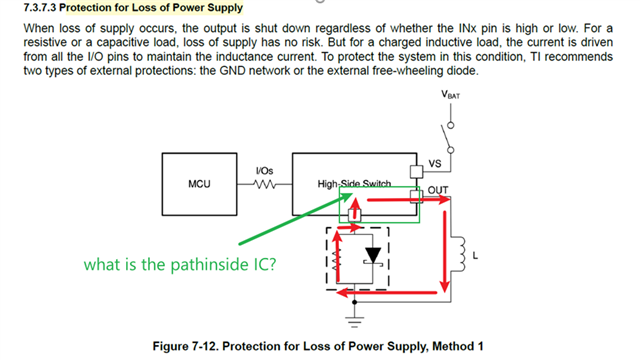

For TPS2H160-Q1, I want to know what is the power path of “GND network” protection during loss of supply?
Is my understanding is right as red path?

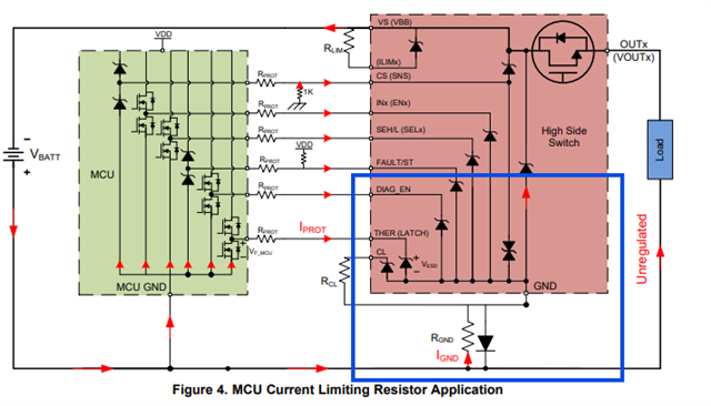

Hey Leo,
This is outlined in our application not above!
