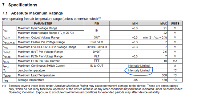

In my design, I use TPS259631. If a short circuit happens at the device's output, the overtemperature protection activates. How long can the device remain in this protected state? Will it continue functioning in steady state (for example, for a week or two)? I couldn't find any information about it in the data sheet.

    When output short happens, device will go into fast trip and then will perform current limit startup and then Over temperature protection activates. Device will perform auto-retry so it will keep on cycling between current limit startup, OTP and cool down. If the average junction temperature is not exceeding the abs max temperature, then there is no issue even if this goes on for weeks. If the average junction temp exceeds the abs max temperature, then the reliability will get affected.
    If you use latch off variant, then there will be no retries but then system will have to enable cycle or power cycle to start it again.

  • Hi Arush,
    Thanks for your response.
    Looking into the data sheet, there is no specified value for the abs maximum temperature:
    How can I ensure the average junction temperature does not exceed the absolute maximum temperature?
    I'm using the Auto-Retry variant.

  • Also, we have max recommended junction temperature of 125C.
  • Hi Arush,
    The output of the TPS2596 goes to an external connector of an electrical unit that I don't control. If a short circuit occurs, a notification will be sent, but there is time before someone disconnects the connector and stops the short. I want to ensure that the IC is not damaged, and more importantly, that it does not compromise the input voltage (power supply).
    The option you suggested won't work for me, I need a package with PowerPAD and good accuracy.
    About the 125 °C junction temperature, the data sheet mentions that the over temperature protection will start working only at 157 °C:
    Does that mean that in case of a short circuit the IC will damage?
  • Hi Eliyahu,
    The IC won't get damaged. My earlier concerns were that average temperature can remain higher than recommended max. I had further discussion with the design team.
    I realized that I missed an important point here. The retry delay timer when designing this part was selected such that the average temperature when we have this continuous retries happen will be lower than the recommended max temperature. This retry timer delay will allow the device to cool down significantly.
    So no concerns with this application (even with auto-retry variant).
    Arush
