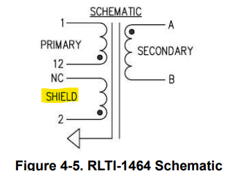

Do we have any reason the UCG28826 EVM uses transformer which has "SHIELD"?

It helps to reduce common mode noise by reducing the parasitic capacitance.

Do you think shield is needed for general cases of UCG28826? At a circuit of traditional flyback converter, my customer is using transformer which does not have shield.

Not necessary, it had been used because it helps in CM noise reduction.
