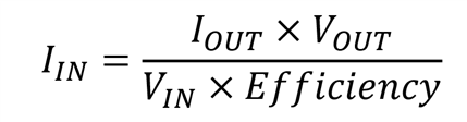

  • Hi Sam,
    The TPS7H4010-SEP will provide a constant voltage and deliver current to the load between 0-6A according to the load.
    As a buck converter, the current at the input to the converter is determined by the output current, switch duty cycle, and efficiency losses:
    Since a buck converter regulates the input to a lower output voltage, the current at the input is also lower than the output current.
    Please let me know if that did not address your question.
    Andy
